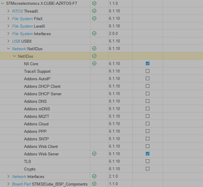

I'm trying to use the .extSettings file to add files to my project and followed the description in "UM1718.pdf". Unfortunately, this don't work. I'm using STM32CubeMX to create a "Dummy" project for STM32CubeIDE.
here is the content of my .extSettings file:
[Groups]
Middlewares/ST/netxduo/addons/ftp=C:\Users\xxxxxx\STM32Cube\Repository\Packs\STMicroelectronics\X-CUBE-AZRTOS-F7\1.1.0\Middlewares\ST\netxduo\addons\ftp\nxd_ftp_server.c;C:\Users\xxxxxx\STM32Cube\Repository\Packs\STMicroelectronics\X-CUBE-AZRTOS-F7\1.1.0\Middlewares\ST\netxduo\addons\ftp\nxd_ftp_server.h
Web_Content=D:\cloud\OneDrive_Intector\project_team\TAG-ID\dev\web\E-Paper\index.html
I'm expecting to find this in the STM32CubeIDE project view:
But this is what I really find:
I hope to find some answers to this issue, because STM32CubeMX is buggy enough even without this.

There can be several reasons why CubeMX doesn't take into account the .extSettings file.
- Sometimes the new files are added in STM32CubeIDE .project file but the Project Explorer view is not updated. Try to do a "Refresh"  on the project in project explorer view (use right click menu) or delete the project from the workspace  (without deleting the project files content) and re-import it in CubeIDE.
- try to add a semi colon ";" at the end of each line in [Groups] section
- have a look at STM32CubeMX.log file in .stm32cubxmx directory in your home directory

Thank you for the fast answer to my post. The use of the .extSettings file is just a way to add some functionality to my project which is not provided by the STM32CubeMX software. Let me explain my problem to show you why I'm trying to use the .extSettings file. For an easier follow up, I've attached my project.
I'm using the NUCLEO-F767ZI board to run a HTTP server which loads the content from an attached SD-Card. The card is connected to the default SDMMC1 of the NUCLEO-F767ZI board. There're some issues with the generated SD-Card files, but I mentioned this in a different post (Solution for STM32-F7 SDMMC in 4-Bit wide bus mode... - STMicroelectronics Community). I like to use the FTP-Server from NetXDuo to be able to change some content of the SD-Card from the web interface. Unfortunately, STM32CubeMX don't offer any of the FTP functionality offered by the NetXDuo even it is included in the "x-cube-azrtos-f7" software extension pack.
However, I tried to manually copy the files into my project, but this don't work because STM32CubeMX deletes everything which isn't configured withing this software. I manually copied the files for the NetXDuo FTP-Server outside of the STM32CubeMX realm, but this would require many changes in the standard code to work correctly.
The only option left is the .extSettings file. I tried everything including the options you mentioned in your answer, but nothing works and STM32CubeMX is persistent ignoring the .extSettings file.
Is there any reason why STM32CubeMX don't offer all the NetXDuo addons, especially the FTP functionality. One would think this is something pretty standard and could be done very easy.
Also, I wasn't able to locate the "STM32CubeMX.log" file anywhere on my computer. I'm not sure what you mean by ".stm32cubxmx directory in your home directory"

I see in the project you provided that you generate for STM32CubeIDE and use STM32CubeMX options "Generate under root" (in Project manager/Project) and "Copy only the necessary library files" (in Project Manager / Code Generator).
It seems that in this configuration, CubeMX generates a CubeIDE .project file with no link to any source file. In this configuration, CubeIDE will compile all the .c sources files that it finds in the directory where .project and .cproject are located (and directories below).
In particular, in this .project file there is no "group" (virtual folder) because there are no "linked files" (<link> tags in .project). You see directly the real folders that are present at same level as .project file and below.
If you select CubeMX Project option "Add necessary library files as reference in the toolchain project configuration file" then CubeMX will generate a CubeIDE .project file with links to source files specified in CubeMX configuration and .extSettings file. CubeMX will put these files in the "virtual folders" (groups) indicated in .extSettings. it is the <linkedResources> and <link> tags in .project file.
Regarding the selection of Netxduo FTP add-on, it was not specified inside the X-Cube-AZRTOS-F7 package (no specific bundle in the *.pdsc file). I guess it was estimated as not important. The files are still present in the repository though.
