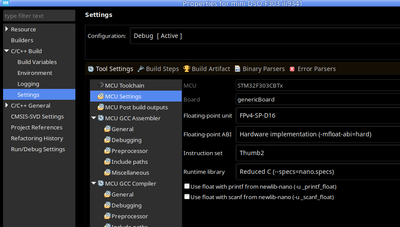

Hi, i get this error, can someone please help me, thanks. I use Cube MX(STM32-cube-ide).
I tried to follow the steps but it didn't work.
AScha.3
In menu->project->properties set : "use float w. printf"

AScha.3
Thanks!
