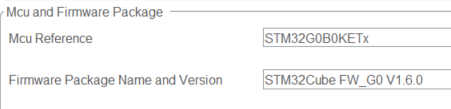

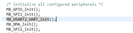

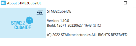

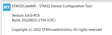

I'm sorry but that doesn't works for me, i have updated cubeIDE to 1.10.0 to have CubeMX 6.6.0 and CubeFW_1.6.0, forced by the new version :( ...
0693W00000QKSCiQAP.png0693W00000QKSCEQA5.png0693W00000QKSDqQAP.pngAfter generation, i still have the error, USART is initialized before DMA !!
Thanks,
Thomas.
