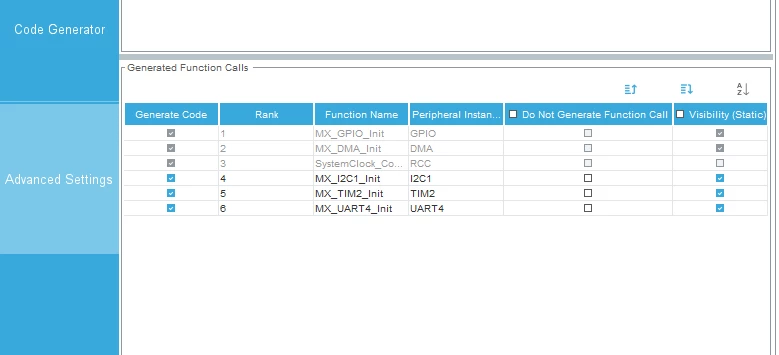

For old projects, hereafter some steps to overcome this misbehavior:
  1. Open the saved .ioc file (already created with 6.3.0 version) with any text editor installed in your machine and delete the line: ProjectManager.functionlistsort=.....
  2. After saving the modification, re-open the .ioc file with latest CubeMX version 6.4.0 ( STM32CubeIDE Version: 1.8.0).
  3. Through Project Manager view > Advanced Settings tab, make sure that the initialization functions are correctly ordered and re-generate your project:
0693W00000GZRkyQAH.pngThe project will be correctly generated.
Hope this will help. Otherwise do not hesitate to raise any feedback.
