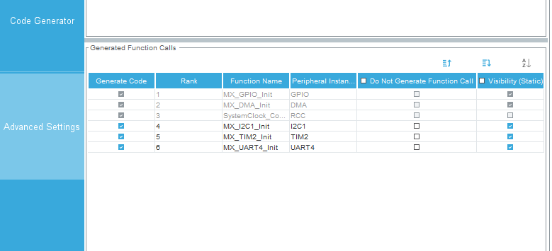

‎2021-11-30 1:36 AM
Hello @mantisrobot​ ,
As I've already stated, the MX_DMA_Init wrong order is corrected in the latest CubeMX version. Hence newly created project with this version will generate the correct initialization functions order.
For old projects, hereafter some steps to overcome this misbehavior:
- Open the saved .ioc file (already created with 6.3.0 version) with any text editor installed in your machine and delete the line: ProjectManager.functionlistsort=.....
- After saving the modification, re-open the .ioc file with latest CubeMX version 6.4.0 ( STM32CubeIDE Version: 1.8.0).
- Through Project Manager view > Advanced Settings tab, make sure that the initialization functions are correctly ordered and re-generate your project:
The project will be correctly generated.
Hope this will help. Otherwise do not hesitate to raise any feedback.
Khouloud.

‎2021-11-30 1:36 AM
