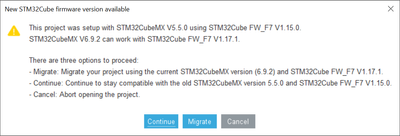

Hello!
I have created a project using cubemx a few years ago. i know which cubemx version i have used in this project but i cant seem to find out which cube repository version i have used.
What is the way to find it? can i find the repository version somewhere in the code?
thanks in advance for your advice :)

... alternatively you can open the IOC with your preferred text editor and search for FirmwarePackage, which also contains this information.

Hello @yuri CH
Once you open your ioc file, a window will pop up to indicate the version of MX used and the CubeFW version. Here is an example
I hope this helps!

There are defines in stm32h7xx_hal.c that tell you the HAL version used. Can use this to correlate with package version.
 * @brief STM32H7xx HAL Driver version number V1.11.0
#define __STM32H7xx_HAL_VERSION_MAIN   (0x01UL) /*!< [31:24] main version */
#define __STM32H7xx_HAL_VERSION_SUB1   (0x0BUL) /*!< [23:16] sub1 version */
#define __STM32H7xx_HAL_VERSION_SUB2   (0x00UL) /*!< [15:8]  sub2 version */
#define __STM32H7xx_HAL_VERSION_RC     (0x00UL) /*!< [7:0]  release candidate */
