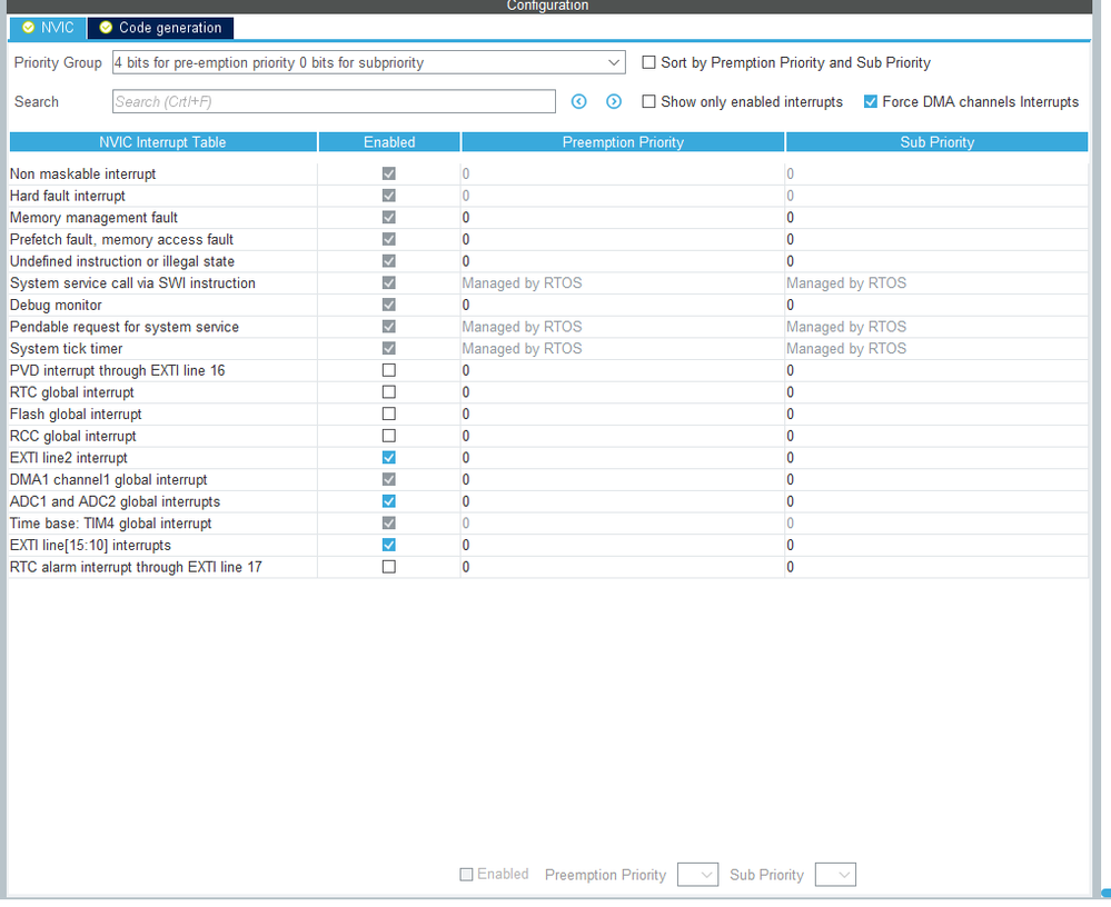

What a trouble in new version of CubeMX 6.0 ?
Why :

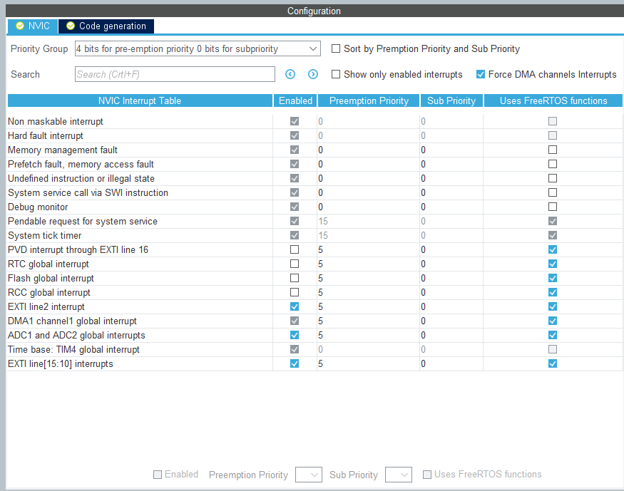

1. CubeMX v.6 reset preemtion priority to 0 from any nonzero values in projects whth FreeRTOS when to migrate from old version?
This is original setting:
this is migrated to 6:
2. Where a checkbox "Uses the FreeRTOS functions" in NVIC tab ?

Hi @Vyacheslav​ ,
Glad to know that your problem is already resolved thanks to 6.0.1 release of STM32CubeMX.
A similar issue was already reported in this discussion and confirmed by ST.
