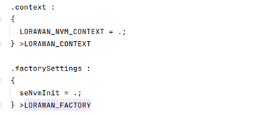

I found in lora_app.c a "User Code" section;
/* USER CODE BEGIN LoRaWAN_Init_2 */
(line 426 in my case, I guess may vary a little bit) that is after the initialization but before the JoinRequest.
Tried to set up the keys there by calling SecureElementSetXXX() functions, but doesn't work.
Niclas Hedhman

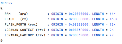

So, I am setting up linker script as @Andrew Larkin suggested and going to use an external tool to populate the Flash.
MEMORY
    RAM (xrw) : ORIGIN = 0x20000000, LENGTH = 64K
    FLASH (rx) : ORIGIN = 0x08000000, LENGTH = 160K
    FLASH_FORTH (rwx) : ORIGIN = 0x08028000, LENGTH = 92K
    FLASH_NVM (rwx) : ORIGIN = 0x0803F000, LENGTH = 2K
    LORAWAN_CONTEXT (rwx) : ORIGIN = 0x0803F800, LENGTH = 2K
.embeddedKeys :
    *(.USER_embedded_Keys)
    LORAWAN_NVM_BASE_ADDRESS = .;
    FILL(0xFFFFFFFF);
    . = ORIGIN(LORAWAN_CONTEXT) + LENGTH(LORAWAN_CONTEXT) - 1;
    BYTE(0xFF)
} >LORAWAN_CONTEXT
That also takes care of the LORAWAN_NVM_BASE_ADDRESS to be from linker script rather than buried in lora-app.c.

1. The location of seNvmCtx is undefined so it is necessary to add an explicit allocation mapping in the linker script for .USER_embedded_Keys. Once this is done, precise memory locations for the keys can be determined to allow them to be overwritten during production.
2. The location of the application-stored context is improperly defined as an absolute memory location (0x0803f000) instead of being properly mapped via the linker script. This means there is no protection from conflicting use of the memory. The presumption that the last couple of pages of flash are "available" is inherently unsafe.
This conflict is NOT theoretical.
If the additional LoRaWAN packages functionality is enabled, then the Fragmented Data Block Transport package is enabled. This package also explicit uses the same region of flash (0x0803F000) (see frag_decoder_if.h)
Amending a previous comment I made about generating a CRC32 value, it is not necessary for the seNvmInit data as the CRC field is not used there - it only seems to be relevant in the ram Nvm copy, backup ram Nvm and saved context in flash as an integrity check.
Nice overview! And yes, I have defined 0x0803f000 and 0x0803f800 as two regions in the linker script, and removed the seNvmInit declaration i soft-se.c, and removed LORAWAN_NVM_BASE_ADDRESS and introduced LORAWAN_NVM_CONTEXT, which (with the definitions below) is a variable (declared as an array will get the address when used).
extern uint8_t LORAWAN_NVM_CONTEXT[2048];

I chose a different memory arrangement in the ld linker script as follows:
/* Memories definition */
MEMORY
RAM2 (xrw) : ORIGIN = 0x10000000, LENGTH = 32K
FLASH (rx) : ORIGIN = 0x08000000, LENGTH = 250K
LORAWAN_FACTORY (rx) : ORIGIN = 0x0803E800, LENGTH = 2K
LORAWAN_CONTEXT (rx) : ORIGIN = 0x0803F000, LENGTH = 4K

I know you were trying to avoid unneeded the use of an extra 2k page, but I wanted to keep the memory structure the same for two reasons:
1. There is a good chance I will be using the fragmented data block support and I definitely didn't want it to be overwriting the seNvmInit data!
2. Support for KMS looks like it does require both pages of memory, if I ever want to turn this on as well.
I think both issues will come into effect if I start playing with FUOTA which I very much want to have running.
