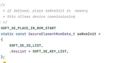

I am hitting the same conundrum.
On a previous project (LoRaWAN 1.0.2), I reserved a page of flash to store DevEUI, keys, etc that could be programmed during production and just picked up the values.  This is a bit "hacky" but worked.
If KMS is not enabled, the keys from se-identity.h are placed in seNvmInit{}, which is then linked into memory section defined by
SOFT_SE_PLACE_IN_NVM_START as __attribute__((section(".USER_embedded_Keys")))
However, this memory section isn't defined in the .ld file, so I can't predict where it will be placed.
A part of the solution is to modify the .ld file to reserve space for the USER_embedded_Keys section.
I am using the STM32WLE5CCUX_FLASH.ld file here.
I changed the /* Memories definition */ to reduce the FLASH section length and add a KEYS section
MEMORY
RAM (xrw) : ORIGIN = 0x20000000, LENGTH = 64K
RAM2 (xrw) : ORIGIN = 0x10000000, LENGTH = 32K
FLASH (rx) : ORIGIN = 0x08000000, LENGTH = 252K
KEYS (rx) : ORIGIN = 0x0803F000, LENGTH = 4K
Then added thisto the end of the ld file, just before /DISCARD/
/* USER Embedded Keys data into "KEYS" Rom type memory */
.embeddedKeys :
. = ALIGN(4);
*(.USER_embedded_Keys)
. = ALIGN(4);
} >KEYS
This at least gets the seNvmInit structure (containing the keys) into a known location, but I have still to figure out which bytes are what.
One thing that bothers me though is prospect of being clobbered by the Context Management support. The default implementations of OnStoreContextRequest() and OnRestoreContextRequest() assume ownership of flash memory at LORAWAN_NVM_BASE_ADDRESS which is
* @brief LoRaWAN NVM Flash address
* @note last 2 sector of a 128kBytes device
#define LORAWAN_NVM_BASE_ADDRESS ((void *)0x0803F000UL)
This, to me, is bad coding behaviour as the address/memory allocation for LORAWAN_NVM_BASE_ADDRESS should also be defined within the ld file
I am dredding what all this might do to a future task which is to figure out how flash is managed for FUOTA.

So, I am setting up linker script as @Andrew Larkin suggested and going to use an external tool to populate the Flash.
MEMORY
    FLASH (rx) : ORIGIN = 0x08000000, LENGTH = 160K
    FLASH_FORTH (rwx) : ORIGIN = 0x08028000, LENGTH = 92K
    FLASH_NVM (rwx) : ORIGIN = 0x0803F000, LENGTH = 2K
    LORAWAN_CONTEXT (rwx) : ORIGIN = 0x0803F800, LENGTH = 2K
.embeddedKeys :
    LORAWAN_NVM_BASE_ADDRESS = .;
    FILL(0xFFFFFFFF);
    . = ORIGIN(LORAWAN_CONTEXT) + LENGTH(LORAWAN_CONTEXT) - 1;
    BYTE(0xFF)
} >LORAWAN_CONTEXT
That also takes care of the LORAWAN_NVM_BASE_ADDRESS to be from linker script rather than buried in lora-app.c.

On the second point of the factory settings, the code already tags the seNvmInit with the USER_embedded_Keys segment, so I think the cleaner way to handle this is to locate the segment where you need it.
This solution also remains "clean" to code regeneration.
