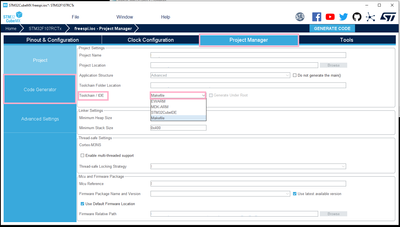

Hello @Joseph.Paul,
You can export the Makefile with STM32CubeMX by selecting "Makefile" in toolchain/IDE as shown in the below figure.
