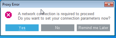

I use the CubeMX in batch mode on a "nightly buid machine" without an internet connection.
Now with CubeMx version 5 there is always a dialog box "Proxy Error" popping on which prevents the further processing of the batch file so that the code could not be created and tested. Is there a way to get off that dialog box ?

Running CubeMX 5.2.0
The same issue over-here, before we could set "Test=0" in the updater.ini file, which doesn't work anymore.

Also the command line argument -i doesn't work anymore and the in CLI mode on linux a X11 display must always be available (GUI needed for splash and error messages)

Actually -i is working, but the GUI is still shown... so a little misleading...

We are still struggling with this proxy popup in our headless builds... we cannot upgrade our toolchain currently; ST can this be solved ASAP so we can upgrade our automated build without GUI and internet connectivity?

We have the same problem with our headless builds. Is there now a solution from ST or any workaround?

Sorry for necroposting, I have the same issue (proxy error, can not connect to internet) with 6.5.0 in both win7 and win10. Reverting back to 6.2.1 works fine. In fact, 6.5.0 seems to have few other bugs too, so if you don't need to use STM32Cxx or STM32Uxx (it seems the only stuff that was added to the upgrade), then you should better stay to 6.2.1 which is stable.
