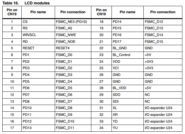

I am attempting to use the STM32CubeMX to generate a base project for the STM3240G-EVAL, specifically attempting to use the evaluations boards LCD. However when I enable the FSMC in CubeMX and configure it, the pins it assigns are in a different order then what the BSP and demonstration firmware use. I am unable to modify the arrangement of the pins, effectively making the code CubeMX generates useless. I have also tried enabling ''Initialize all IP with their default Mode'' when selecting the STM3240G-EVAL in the board selector and get the same pinout. Is there a way to change the assigned FSMC pins with CubeMX, or is this a bug in the definition file for the board that can be resolved? Pinout from STM3240G-EVAL Spec Sheet for LCD: 0690X00000604nbQAA.png Pinout generated from STM32CubeMX:

Thank you for your feedback. The issue has been reported internally.

Dear user,
The pin names you find in the LCD module table correspond to the pins of the LCD module and not the pins of the MCU on the board.
The list coming out of MX mentions the MCU pins on which the different FSM signals are connected.
