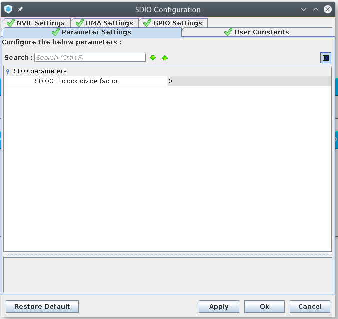

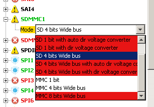

Whether using SDIO or SDMMC, CubeMX does not provide necessary configuration parameters available for these units. It also does not configure Bus Width, only generates 1Bit Bus configuration. Also setting BusWide to 4Bit does not initialize sd card. It only works in 1Bit mode.
These are therequired parameters to be available at CubeMX
void MX_SDMMC1_SD_Init(void)
 hsd1.Instance = SDMMC1;
 hsd1.Init.ClockEdge = SDMMC_CLOCK_EDGE_RISING;
 hsd1.Init.ClockBypass = SDMMC_CLOCK_BYPASS_DISABLE;
 hsd1.Init.ClockPowerSave = SDMMC_CLOCK_POWER_SAVE_DISABLE;
 hsd1.Init.BusWide = SDMMC_BUS_WIDE_1B;
 hsd1.Init.HardwareFlowControl = SDMMC_HARDWARE_FLOW_CONTROL_DISABLE;
 hsd1.Init.ClockDiv = 0;
and this is a picture of available parameters at cubemx
0690X00000608BGQAY.png #bug #cubemx #sdmmc #sdio

As I mentioned above, setting bus width to 4bits does not work and it only works in 1bit mode.
My board is STM32F746G-Disco.
