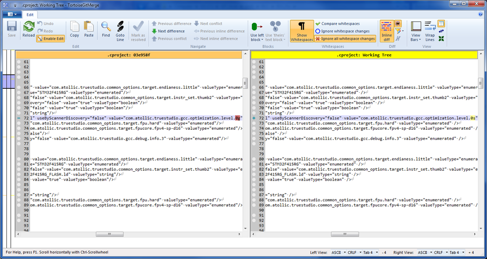

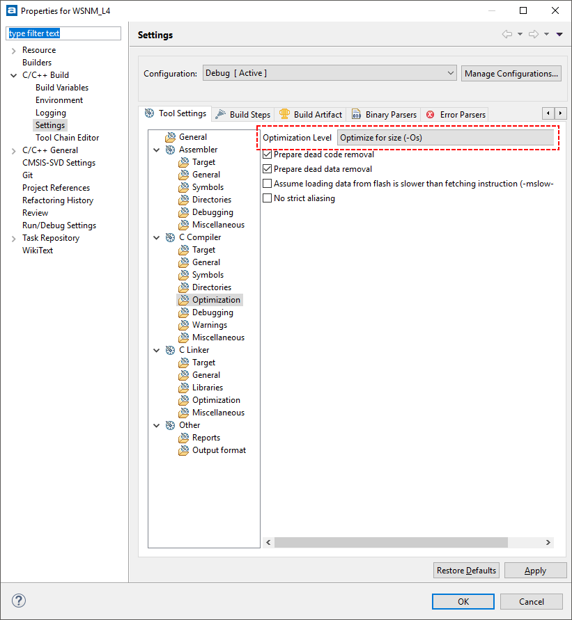

The problem is that each time one regenerates the project using CubeMX, the optimization flags get reset to -Os, no matter what was set before:
Debug level flags are preserved correctly. @Imen DAHMEN​  ?

I can comfirn this bug. It even resets optimization flags in my new configuration what I made.0690X000006BzQaQAK.png

Can you please give your Atollic TrueSTUDIO version and the MCU used.
Because using STM32F401, I cannot reproduce the bug. I change the optimization level to -0g and when i regenerate the code, it was kept, it wasn't changed to -Os,
