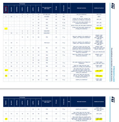

‎2024-12-24 5:02 AM
Hello @another_user ,
Related to DS14581 ; Table 12. STM32U031x4/6/8 pin/ball definition.
- ADC1_IN4 should not exist on STM32CubeMX.
-ADC1_IN11 ; ADC1_IN15 ; ADC1_IN19 signals should exist on STM32CubeMX.
I am escalating an internal ticket to the detailed team (199314)
Thanks.
