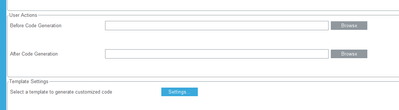

I recently upgraded my CubeMX to V6.12.1 from V6.6.1. All of a sudden, I have realised that when I generate code from the updated CubeMX, it removes my Post build command line from my IAR EWARM project.
Is there a new setting or such that I am missing that does not do that? Or is it a CubeMX problem?
I thank you in advance!

Thank you for the solutions, however, it did not work. I was using 6.6.1 earlier where this problem was not there.
For solution 1 - Along with backing up the files, I also unchecked the "Delete previously generated files if not re generated" option, but that did not help either.
As for no. 3, I did check the configuration, and it looks okay when I add the post build command into it manually. However, on generating code from CubeMX, it is removed.
I can see that in the code generator, there is an option of user actions before and after code generation.
Is there any literature available on how to use this feature? Could something be done in this feature that prevents my project settings from changing?
