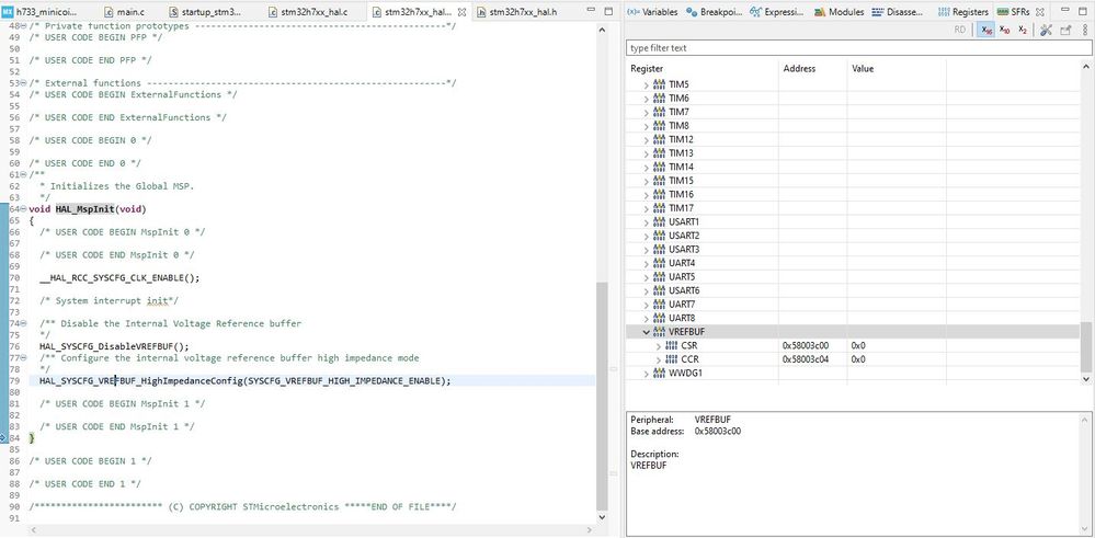

STM32CubeMX Version: 6.1.0-RC2 Build: 20201112-1557 (UTC)
STM32CubeIDE Version: 1.5.0 Build: 8698_20201117_1050 (UTC)
CubeMX generated code missing clock enable command before VREFBUF configuration.
cube configuration:
Generated code:missing "__HAL_RCC_VREF_CLK_ENABLE()" prevents any configuration...

Hello @Michal Dudka ,
Thank you for raising this issue, it will be reported internally to be reviewed and fixed. I'll keep you posted with the updates.
Sorry for the inconvenience and thanks for your contribution.
