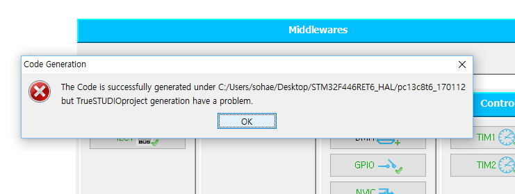

I'm using CubeMX 4.18.0 recently.
by the way,
Every time An error occurs when creating a TrueStudio project using the CubeMX 4.18.0.
Please, help.
#cubemx #truestudio

Imen.D
Posted on January 12, 2017 at 09:27
Which version of
TrueStudio using ? Make sure to use the last version.
Maybe this is due to a long path issue. So, try to change with the short path. Do a clean then rebuild and import to
TrueStudio
Please keep us informed on your progress
Thanks
Imen

Posted on January 12, 2017 at 09:43
and,
Because of this problem, I was able to format the my Computer and install new TrueStudio 7.0.1
and CubeMX 4.18.0, but I could not solve the error.
Posted on January 12, 2017 at 09:58
Long path problem.
Creating a project on a desktop created normally.
However, long path problem should be solved.
thanks.
Posted on January 12, 2017 at 10:23
After modifying a project created by another cubemx version of the projects,
the same error occurs after regenerating the code.

Posted on January 16, 2017 at 03:02
Hi
After updating cubemx to 4.19.0, the problem has been resolved.
I'll give feedback through more tests.
Thank you for developing the cubemx Development team.
Posted on January 29, 2017 at 15:29
The error occurred in 4.18.0 CubeMX, also known as CubeMX 4.19.0.
I'd like to attach a project file, so what should I do?
target mcu : stm32f103c8t6
compiler : TrueStudio 7.0.1
CubeMX : 4.19.0
