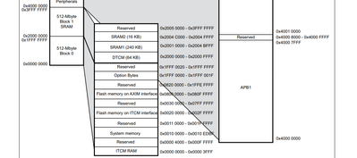

Sarra.S
Hello @KMill, you are right
The default value causes a Hardfault as the address is in a reserved region:
I'm creating an internal ticket to correct this (Internal ticket number: 200083)

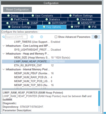

OWLchan
thanks for saving my day, I'm using STM32CubeMX version '6.13.0' to generate code and got the error as you said above, I wonder if ST has fixed that error or has a guide because it's very inconvenient every time I generate code again.
and one thing I just discovered is that previous versions of STM32CubeMX don't seem to generate anything similar to #define LWIP_RAM_HEAP_POINTER 0x30004000
UPDATE: I found a way to fix this problem, just change the address of LWIP_RAM_HEAP_POINTER to sram
I too changed the value in that field to 0x20010000 (sram) but I was not confident in the fix, having drilled through the macros that LWiP uses.

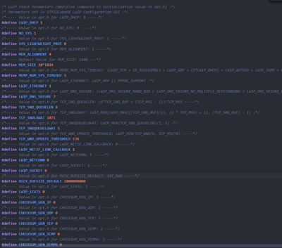

your comment is right but that is actually what is going on, i looked a little at :
  lwip_init();
