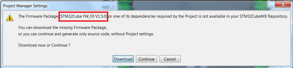

Using the attached cube project TestSTM32F051R8_TimError.ioc
When I generate the source codes the CubeMx version  4.20.0 produces the following initialization code for the timers (I used only TIM1 and TIM3) but the error is exactly the same for both of them.
void MX_TIM1_Init(void)
TIM_ClockConfigTypeDef sClockSourceConfig;
TIM_MasterConfigTypeDef sMasterConfig;
htim1.Instance = TIM1;
htim1.Init.Prescaler = 4800;
htim1.Init.CounterMode = TIM_COUNTERMODE_UP;
htim1.Init.Period = 65535;
htim1.Init.ClockDivision = TIM_CLOCKDIVISION_DIV1;
htim1.Init.RepetitionCounter = 0;
htim1.Init.AutoReloadPreload = TIM_AUTORELOAD_PRELOAD_ENABLE;  <--- Error this field is not defined in the structure and also the TIM_AUTORELOAD_PRELOAD_ENABLE is not defined anywhere in the HAL libraries.
if (HAL_TIM_Base_Init(&htim1) != HAL_OK)
Error_Handler();

Dear Leonardo,
You are using an old version of firmware.
Please use the firmware package ''stm32cube_fw_f0_v1.7.0'' which is compatible with the CubeMX version 4.20.0.
You may refer to
http://www.st.com/content/ccc/resource/technical/document/release_note/b2/02/4b/e3/81/32/49/c4/DM00107607.pdf/files/DM00107607.pdf/jcr:content/translations/en.DM00107607.pdf
table5 for further details about the supported firmware package versions.
In the updated firmware, the ''TIM_AUTORELOAD_PRELOAD_ENABLE'' is defined in ''stm32f0xx_hal_tim.h''
Khouloud.
Leonardo Volponi
April 4, 2017
Posted on April 04, 2017 at 19:08
Thank you very much for your suggestion
Khouloud
, unfortunately, I had the F0_V1.5.0 installed in my PC and because of this I didn't get any error message.
Originally the project was made with an old version of the CubeMx and HAL Libraries.
Probably there was a problem, -without any message-, during the migration process.
I supposed that the migration process should change 'automatically' the reference to the correct HAL Libraries.
Now I disinstalled all the old versions of the HAL Libraries, and I will keep only the last one available, at least in this way for the future releases I should get the message you show to warn me about wrong version of the library.
I changed the reference to the correct library version in the project.
With this modification, I solved the problem and there are no more errors in the generated code.
It should be nice to have an error or at least a warning message from the CubeMx also if the old library referenced from the project is already installed in the PC.
I never get any message about old version of the referenced library by the project.
Thank you very much for your very quick reply !

Hi Leonardo,
-> Correct. This is already implemented in the CubeMX tool.
