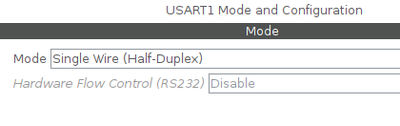

and can you (i dont have this chip, but all similar ) define in Cube half duplex? then only one pin is used.
‎2023-07-23 1:56 AM
I would have loved
I would have loved to do like that but when I put PA15 in UART2_RX, UART2 is not configurable (red mode)
Thanks
‎2023-07-23 2:03 AM
yepp, on half duplex the "TX" pin is used, pa2 here. but now you get pa15 free to use...for exti.
or try alternate pin: first set uart ...as it wants. pa2+15 . then hold ctrl key and click mouse on the pa2 pin + hold key, then blinking all possible alternative pins. if this is something you like, just click on the alternative pin and select ...uart..here. then it uses this pin.
‎2023-07-23 2:07 AM
Selecting half duplex MX selects PA2!
PA2 in the only pin for USART2_TX and MX persists in selecting this pin when USART2 is selected.
If we put PA2 in reset state USART2 is automatically disabled.
Same behavior with USART3.
It seems that MX does not allow to use an UART for RX only. For me it's a bug... Because I commonly do it without using MX.

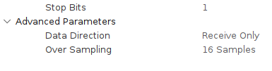

For normal mode selecting "Receive Only" or "Transmit Only" doesn't release the respective unneeded pin. For "Single Wire (Half-Duplex)" mode enabling the "TX and RX Pins Swapping" doesn't move the single allocated pin from Tx pin to Rx pin, which is what the hardware actually does. That's just what RubeMX is. And what's the point of all of this contraption? The HAL broken bloatware cannot receive USART stream without ridiculous hacks anyway. Toss it all away and develop a useful and working code:
