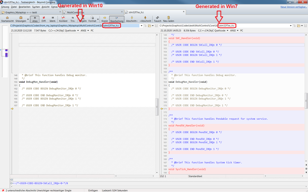

I downloaded the attached file to another system and the project was compiled without error. But when I downloaded it again in my system and created a project, the project was not compiled again and the errors that I attached in the previous post occurred. Maybe I should delete the Cache somewhere? I use STM32CubeIDE.
Slh
Senior
@Khouloud ZEMMELI​

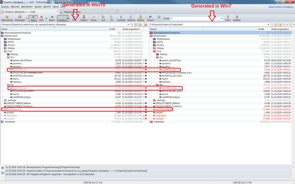

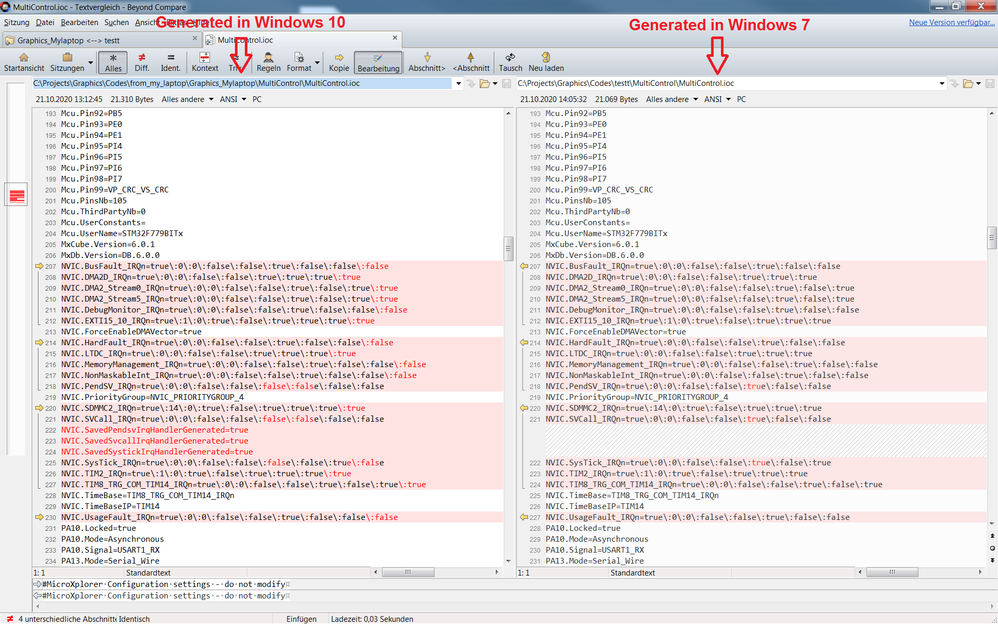

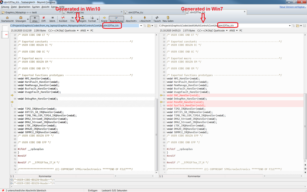

For this problem I found that the code generated from the same file (attached file in first post) is different on two PCs with the same version of STM32CubeIDE (V1.4.2). I have shown these differences in the attached photos. The difference between the two systems is that one is Windows 10 and the other is Windows 7, and the project created in Windows 7 is not compiled with errors that shown in first post.
Compare .ioc files:
0693W000004KX4vQAG.pngCompare project files:
Compare header files:
Compare source files:
