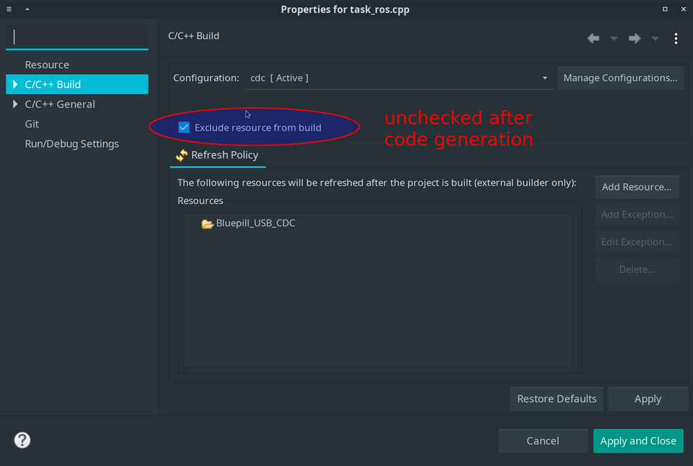

Hi !
After generating code for the tool chain SW4STM32 the Eclipse project setting "exclude from build" for files or folders is reset:
used software versions:
- STM32CubeMx 5.6.1
- Eclipse 2020-06 (4.16.0)
- Eclipse AC6 plugins:
Bug or feature ?
Best regards, Michael.

Thanks for the link, but I think the "issue list" is not up-to-date:
In fact some of the Eclipse projects settings are preserved, but others are not.
This was changing over time but there is still enough room for improvement :grinning_face: .
E.g. the compiler optimization setting was always reset to -o2 but now (Cube version 5.6.1?) this settings seems to be untouched after code generation ...
