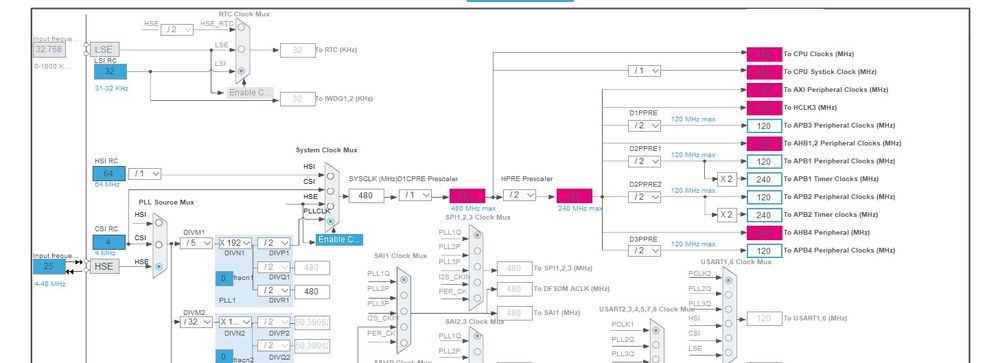

I am reaching out to seek your expertise regarding a clock setup issue that I encountered while using the STM32H743 microcontroller.
My goal is to use up to a maximum of 480MHz system clock using a 25MHz HSE. However, I have encountered some errors in red while setting up the clock in STM32CubeIDE. I am unsure why these issues have occurred, and I would greatly appreciate any insights you may have.
My main question is whether it is possible to achieve a 480MHz system clock using a 25MHz HSE. I would be grateful for any advice you may have regarding this matter.

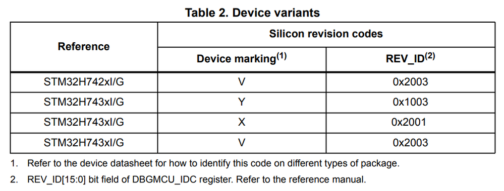

Hello @oseaw.1​ ,
For the STM32H743 , we have 3 revision :
Use silicon revision V devices to reach a maximum frequency of 480 MHz.
Foued
