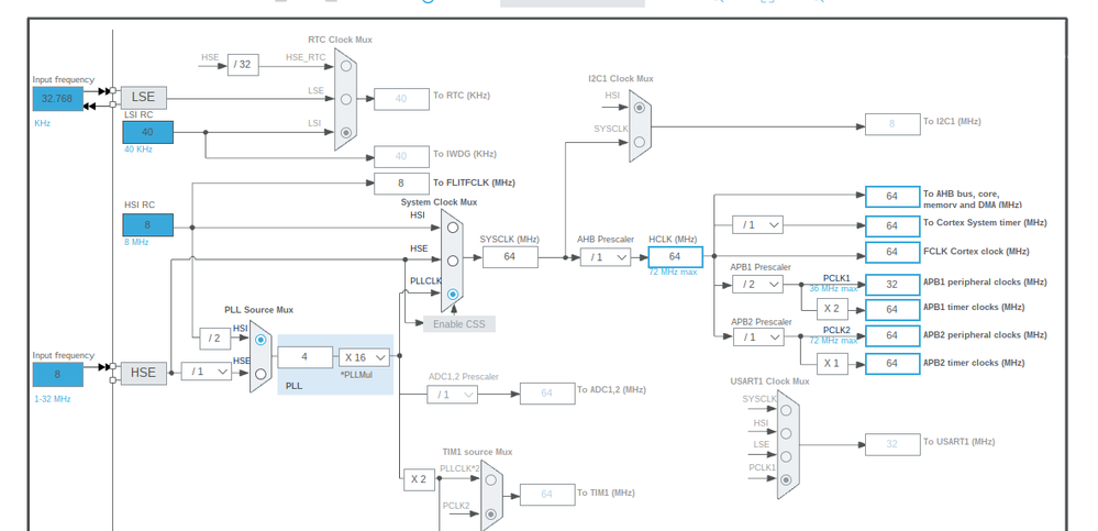

Ok, so I decided to change from Arduino IDE (STM32F103) to STM32CubeIDE (STM32F334R8).
I can't get perfect timing.
My program just have to toogle my pin after x us (that is presented inside a vector)

Other important features:
htim16.Instance = TIM16;
htim16.Init.Prescaler = 64-1;
htim16.Init.CounterMode = TIM_COUNTERMODE_UP;
htim16.Init.Period = 10;
htim16.Init.ClockDivision = TIM_CLOCKDIVISION_DIV1;
htim16.Init.RepetitionCounter = 0;
htim16.Init.AutoReloadPreload = TIM_AUTORELOAD_PRELOAD_DISABLE;
I've already decreased Prescaler, but the result is the same. I was hoping to get the complete opposite. More performance for HAL lib.
I'm clearly doing something wrong.

What do you mean by error? What's the expected and what is the observed behaviour? What is the primary source of clock (HSE, HSI?) and how are clocks set up?
TMaia.1
Thanks JW,
When I address the word error I mean.
Expected time: 420us (this is what I thing I'm configuring)
Measured time: 422.3us (toogle pin)
Error: 2.3us (between configured and measured).
For RCC Mode and Configuration Iḿ using:
HSE (BYPASS Clock Source) - It's default for Nucleo board.
TMaia.1
As it seems. HSI RC error is the problem. I changed to HSE and now is perfect. However, I'm worried. CSS means that HSE will fail? Will it recover itself?
