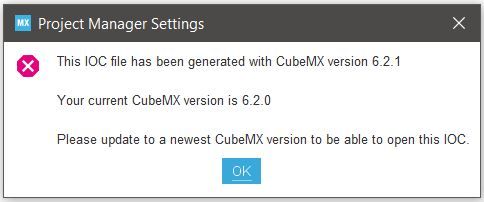

Step to reproduce:
1) Generate a project in CubeMX v6.2.0 and save it
2) Open and modify the 6.2.0 project with CubeMX v6.2.1 (no migration or wathever), save the project
3) try to reopen the project with v6.2.0, these window will popup:
I need to use this project with 6.2.0 version of Cube MX.
looking into the .ioc from text editor, i see these lines:
MxCube.Version=6.2.1
MxDb.Version=DB.6.0.21
Changing these two into:
MxCube.Version=6.2.0
MxDb.Version=DB.6.0.20
with this change I can now re-open the file with previous CubeMX, is this procedure safe? There's something I'm missing that can broke the project?

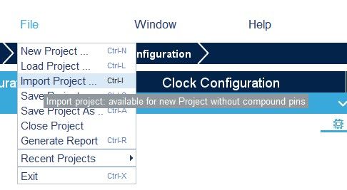

What I can propose in this case is either to:
  • Change manually through a text editor MxCube.Version=6.2.1 and MxDb.Version=DB.6.0.21 to MxCube.Version=6.2.0 and MxDb.Version=DB.6.0.20 (make sure that the STM32Cube firmware version is remaining the same for both STM32CubeMX version 6.2.0 and 6.2.1)
  • Start a new project based on the MCU you're already working with using STM32CubeMX version 6.2.0 and without doing any changes, select the Import project icon that appears under the File. Normally the project will be ported successfully:
0693W00000BbFq5QAF.jpg For more details about the Import project feature, you can refer to the STM32CubeMX User Manual.
