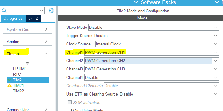

Can't generate PWM with CH1 for TIM2 on STM32L0
‎2020-12-21 6:28 PM
Dear ST;
I can't generate PWM with CH1 for TIM2 on STM32L0 but I can generate PWM with CH3 for TIM2 on STM32L0.

Hi @Gz​ ,
You can generate PWM with CH1 for TIM2 by select PWM Generation CH1 under Timers -> TIM2.
Hope that this help you!

Hi @Houssem CHAABANI​ ;
I found problem. I generate PWM CH1 to compare with PWM CH3.
PWM Channel 1
GPIO_InitStruct.Pin = GPIO_PIN_0;
HAL_GPIO_Init(GPIOA, &GPIO_InitStruct);
PWM Channel 3
GPIO_InitStruct.Pin = GPIO_PIN_1;
GPIO_InitStruct.Alternate = GPIO_AF2_TIM2;
The PWM Channel 1 not included " GPIO_InitStruct.Alternate = GPIO_AF2_TIM2;"

Hi @Gz​ ,
Thank you for your feedback.
This was reported internally and it will be fixed as soon as possible.
In meanwhile you can add the missing configuration manually in your code.
