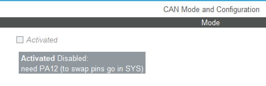

I try to create a project based on CAN bus but the CAN option is disable in CUBEMX ide.
*Controller - stm32f042g6u8
*Cube mx ide version - V 4.24
  • i want to know how to create a CAN BUS project using cubemx & without it,
  • Examples are suggested for better understanding

You can hover over something that is grayed out to find out why. In this case:
So go into SYS to swap pins, then you can enable CAN.
