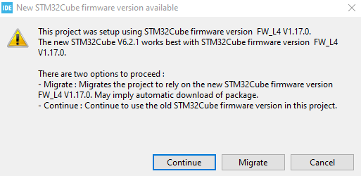

Created with V1.17.0, Works best with V1.17.0, want to migrate?
RFlec.1
I can see your point. You're right, the migration dialog text may be a little bit confusing, so let me explain the message behind this warning pop up.
In fact, STM32CubeMX (same for STM32CubeIDE) detects if the project was created with an older version of the tool and if this is the case, it proposes the user to either migrate to use the latest STM32CubeMX database and STM32Cube firmware version, or to continue.
I assume your project was created with a previous CubeMX version ( 6.2.0 with the database DB.6.0.20). Thus, when loading this project with the latest STM32CubeIDE version (with CubeMX version 6.2.1 inside), the migration warning will be displayed.
To resume, the message behind this migration pop up in your case (i.e., working with the latest FW version in both CubeMX version) is that the project was created with an old MCU database. It exists actually a newer MCU database than the one you used.
Clicking Continue or Migrate will upgrade to the latest database “compatible�? with the SMT32Cube firmware version used by the project.
With that sad, this will be reported internally to be reviewed by our development team to see how we can address a modification to make this message more clear.

Both Versions are the same. How many times do you suggest I should migrate?
Many Greetings!
Remo
