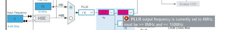

First issue, the indicated limits on PLLR are wrong:
The error suggests the PLL output can be no higher than 150Mhz, which is wrong since the chip supports HCLK freqs up to 170Mhz. Which is also explicitly stated below the HCLK box:

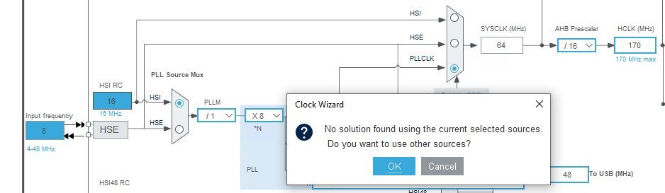

Second Issue, possibly related, the automated search feature, which tries to find a PLL configuration that produces a desired HCLK, fails to find a solution when the user chose target HCLK to be 170Mhz:

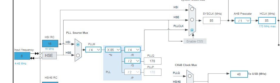

But, if the user sets the target HCLK as 85Mhz, you do get a solution:

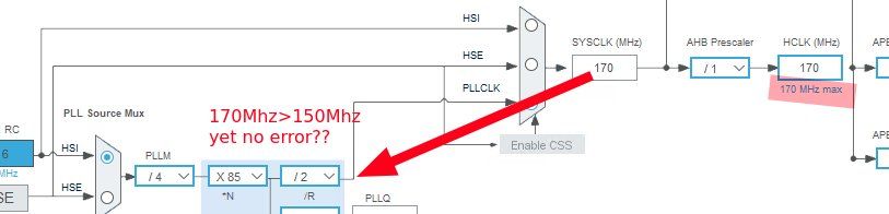

If we then change the PLLR divider to /2 instead of /4, we get the desired HCLK of 170Mhz, and no violation is flagged for PLL/R (as shown above). Something here is clearly inconsistent.
