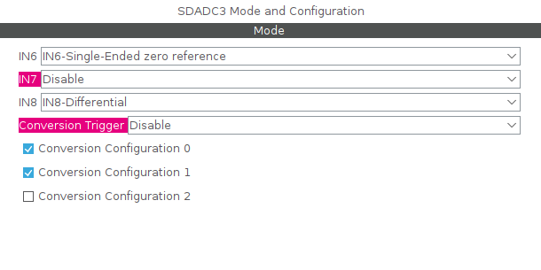

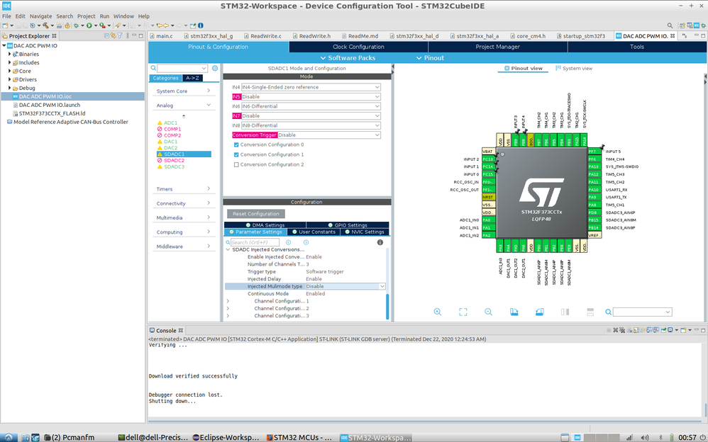

I want to report a bug.
I tried SDADC and I found a bug.
Also it should stand "Multi mode" not "Mulimode" and the STM32CubeIDE 1.5.0 (I'm using) missing calibration options in the STM32CubeIDE project starter.

As you can see in the picture above, I cannot select "Mulimode" because it's disabled. It should not be disabled. It should be an option to select SDADC3 from SDADC1. Therefore, I had to add this manually. Also "Mulimode" is spelled wrong.
But the SDADC works perfectly! I think there is a lack of examples how to use SDADC in STM32.
