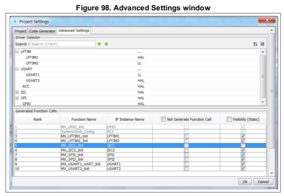

Well I was wanting to organize the way the peripheral / middleware code calls are generated.
Since I did not find anything that gave me this option in the Project Manager / advanced settings, I made the default to find an answer.
Help / Manual.
Here comes the best part, "or I would say, worse," the pdf opens UM1718- Rev 28, I go to page 124 - 4.7.3 Advanced Settings tab and I find this.
Figure 98 shows the peripheral and / or middleware selected for the project.
Ordering initialization function calls.
By default, the generated code calls the peripheral / middleware initialization functions in the order in which peripherals and middleware have been enabled in STM32CubeMX. The user can then choose to re-order them by modifying the rank number using the up and down arrow buttons.
But figure 98 refers to the old version.
Okay, I think, at least it should work the way it is written.
Wrong, does not work, at least for me.
If anyone knows how to do this in version 5.1.0, please explain me.
