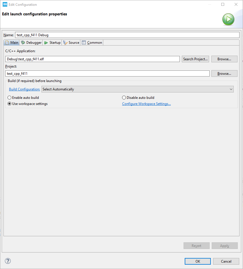

For using need .axf file, not found in my project((. How receive it file? May be need more IDE settings?

Actually STM32CubeMonitor supports various executable file format with .elf, .out or .axf extension from various toolchain/toolset available in you preferred IDE (STM32CubeIDE, Keil, IAR, ...)
As you mentioned, the generated executable file location depends on your IDE settings.
If you are using STM32CubeIDE, you can retrieve the executable file location path by opening the run/debug configuration panel and look at the path specified under C/C++ Application.
In the exemple below, the "test_cpp_f411.elf" file is under "Debug" folder which is a relative path to the project folder :

Looks like you are actually generating "Start100rb_4.elf" file under Debug folder (and not an .axf file). So you should use this "Start100rb_4.elf" file.

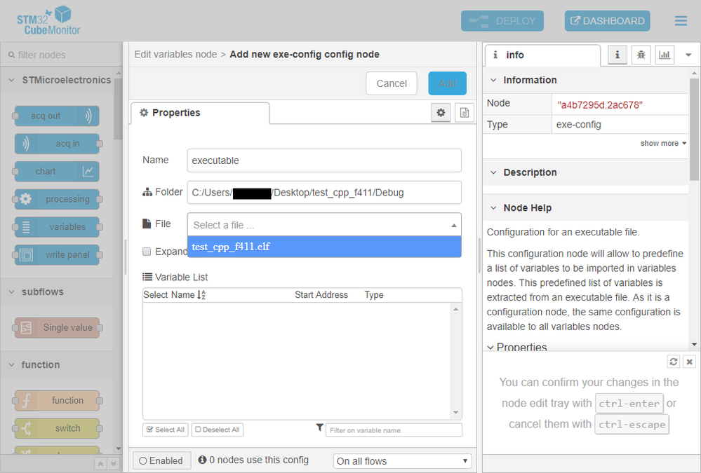

As mentioned in my first post, STM32CubeMonitor also supports .elf file. So you can use the file which is currently generated "Start100rb_4.elf".
Another simple option, is to let STM32CubeMonitor list the executable file by setting the correct path in "folder" field of exe-config node :
