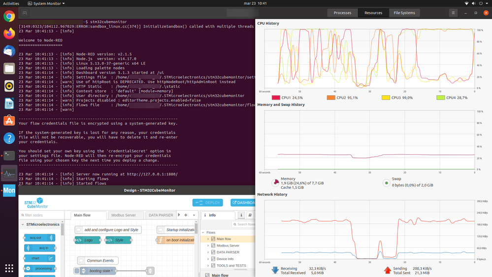

I'm trying to work with STM32CubeMonitor to implement an industrial machine Life Test JIG using 12 ST-LINK v2 probes connected to STM32 microcontrollers by SWD protocol, but I'm facing very strange and anoying issues.
This post will focus only on CPU critical allocation on V1.4.0.

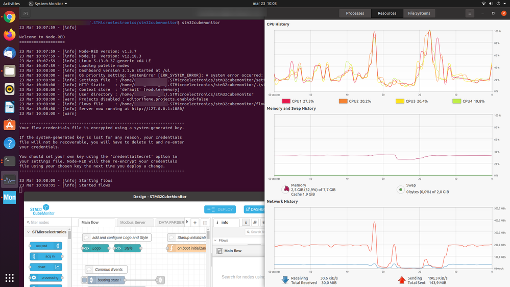

When acq node is started (only after receive start acquisition order) the process allocate 100% of one CPU core.
As shown on the picture below, I'm using at the moment and for development purposes, only two ST-LINK probes, that's why "only" two cores are at 100% allocation.

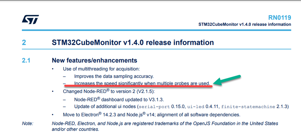

According to V1.4.0 release notes the multiple probe acquisitions was improved.

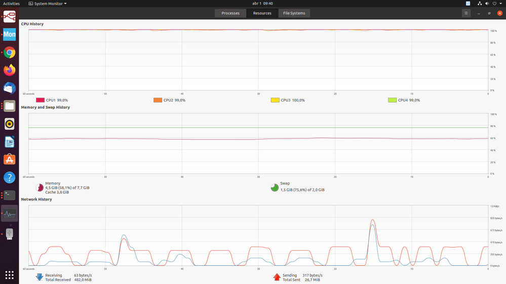

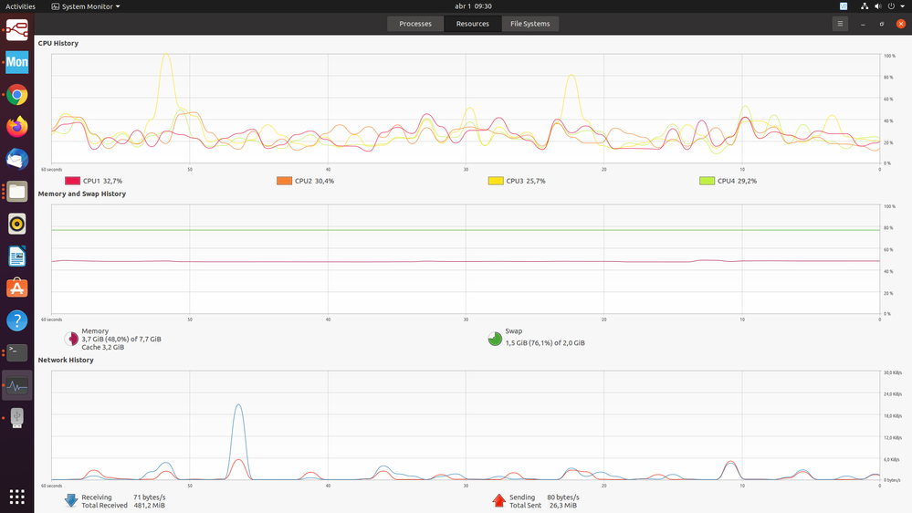

‎2022-04-01 4:11 AM
Hi @Richard.Chvr​
At the moment I have on top of desk a setup wtih 4x ST-LINK V2 getting data at 1Hz each.
With the same flow and HW you can figure out each screenshoot is from V1.3.0 and v1.4.0 cubeMonitor
I'm using a I5 quad core with 8GB RAM and SSD disk
