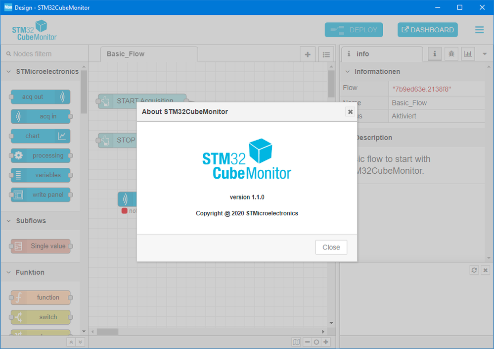

Schmidt.Andreas
The version information under "About STM32CubeMonitor" is still 1.1.0, or am I wrong?
wrong. I see 1.5.0.
hth
KnarfB
Richard.Chvr
Hello @Community member​
Looks like there's an issue if you previously installed another version of the tool and did not uninstall it before the new one. Will raise a ticket to the dev. team.
To give better visibility on the answered topics, please click on Accept as Solution on the reply which solved your issue or answered your question.
Schmidt.Andreas
Hello @Richard.Chvr​ ,
yes, that could be the reason, I did not uninstall the old version.
My system is Windows 10 Pro 64bit / 22H2
BR
Andreas
