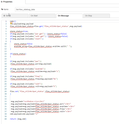

Thanks for the example, it is great as a starting point.
As soon as I open some of the function nodes they have errors.
Has nodeRed got some version changes that is not anymore working, or do I have to do somewhere some global settings?

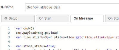

This is relative to nodeRed version changes. It looks it is need now to add "var" declaration with new variable to avoid error. It looks there is no parameter in STM32CubeMonitor to avoid this code update.
I will update the example on my side.
