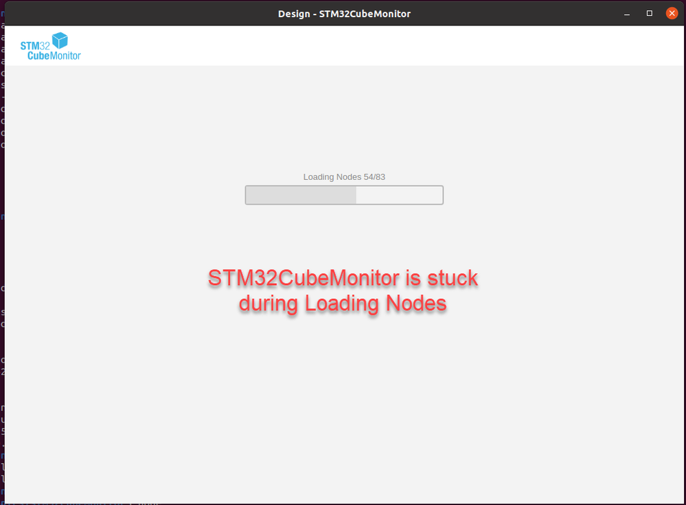

Hi everyone.
I'm trying to secure STM32CubeMonitor Editor and UI as defined to Node-RED, but is not possible secure STM32CubeMonitor.
After define a user and password at settings.js (even only for STM32 CubeMonitor) the editor and UI breaks and are simply useless.
This is a critical issue nowadays, not been able to secure a webserver that can be exposed to remote access, to provide REST API's and so on...
Tested STM32CubeMonitor v1.3.0
In other hand, this features works perfectly on native Node-RED instances.
There is a known workaround to secure STM32CubeMonitor editor and UI with user-password login?
Solved! Go to Solution.

‎2022-10-31 9:46 AM
Hi @Andrea cavani​
The release 1.5.0 is online. It should be possible now to secure the editor properly.
Please, let us know if it is ok with the new version.
Please note: In the default setting.js, the remote access is now disabled by default.

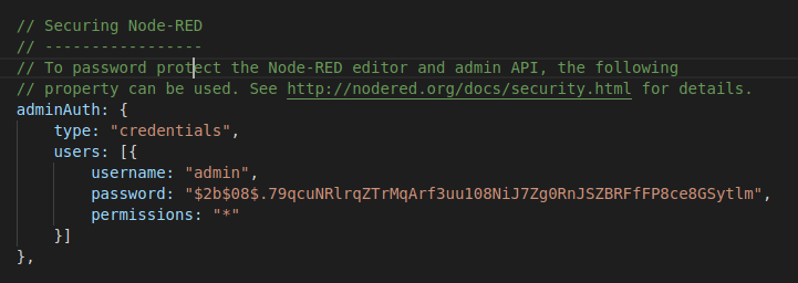

I tried using user and password at settings.js for both STM32CubeMonitor-1.3.0 and newly published 1.4.0 and didn't face any issue such as the one you mentioned (see attached settings.js). Can you detail your environment and the modification you made.
// Securing Node-RED
// To password protect the Node-RED editor and admin API, the following
// property can be used. See http://nodered.org/docs/security.html for details.
adminAuth: {
type: "credentials",
users: [{
username: "admin",
password: "$2a$08$zZWtXTja0fB1pzD4sHCMyOCMYz2Z6dNbM6tl8sJogENOMcxWV9DN.",
permissions: "*"
default: {
permissions: "read"
‎2022-03-31 4:24 AM
Hello @Richard.Chvr​
Going in more detail:
OP: Ubuntu 20.04 desktop
CubeMonitor: v1.3.0
user: admin
password: admin_1234#
FLow: default from ST, after fresh installation

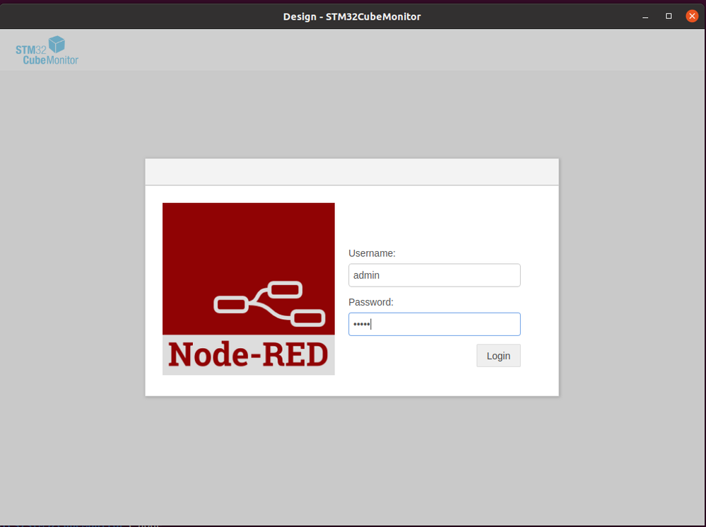

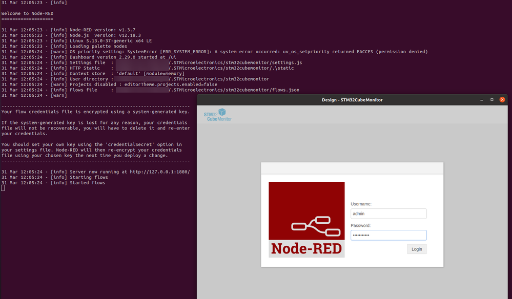

Editor asking for password as expected:

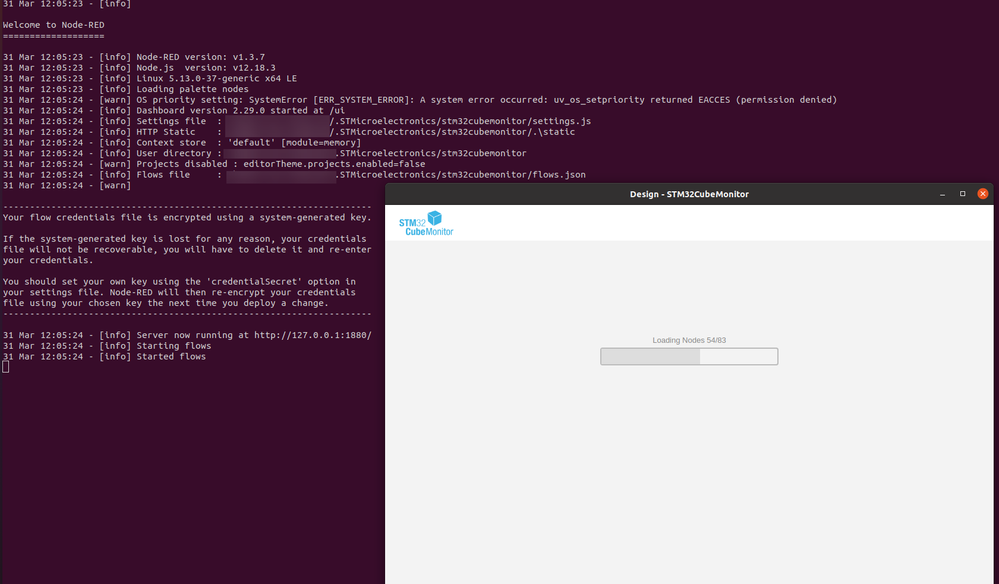

Editor stuck after enter correct password:

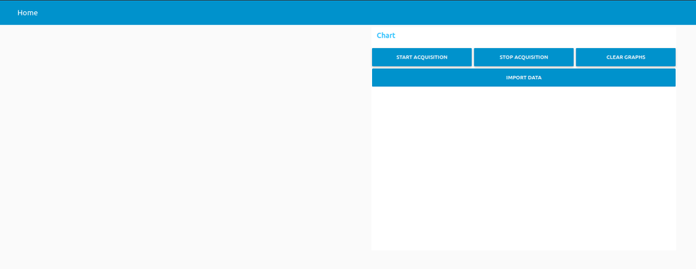

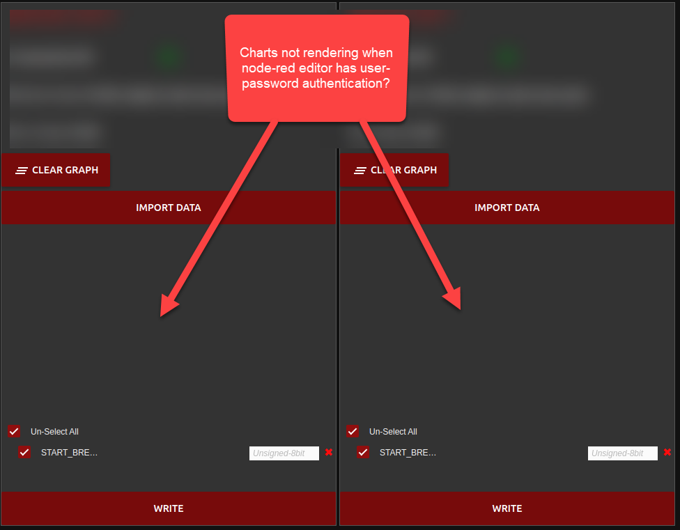

Node-RED UI not working properly after correct login
Please consider flow and settings on attachment.
If you need further details, let me know.
Thank you
‎2022-03-31 6:18 AM
@_acv_atr​
Thank for these details, I've tested this configuration on my ubuntu machine (I previously successfully tested it on windows) and I confirm the issue you face. Will investigate and come back to you.

‎2022-09-29 9:03 AM
Hi @Andrea cavani​
Issue should be corrected in next release 1.5.0 that will come soon.
