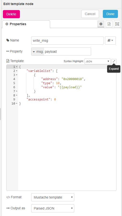

Hi danielspronk9 ,
To write data by flow, the following payload must be sent to probe out node ,with the topic “write�? :
   "variablelist": [
           "address": "0x20000060",
           "type": 4,
           "value": "xxxx"
   "accesspoint": 0
 My proposed solution with standard nodes is :
I have added a slider to generate the value (but can be done by any node) then the “template�? node formats the payload, and the change node set the topic.
the template node content :0693W000000TrYYQA0.png
The variable address and variable type must be filled here. For the type and address, the easiest way it to try first with a write panel and a debug node, and see the values. The payload value from input will be inserted in the template. (the value to write).

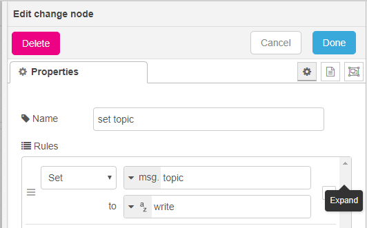

The next node is a “change�? to set the topic to write 0693W000000TrZ7QAK.png0693W000000TrZCQA0.png

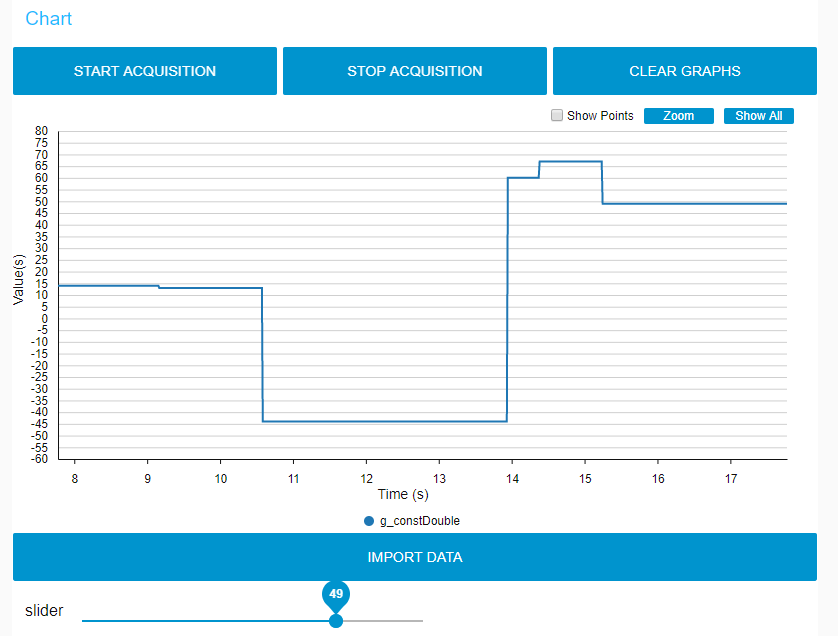

the result :
When the slider is moved, the new value is written to g_constDouble

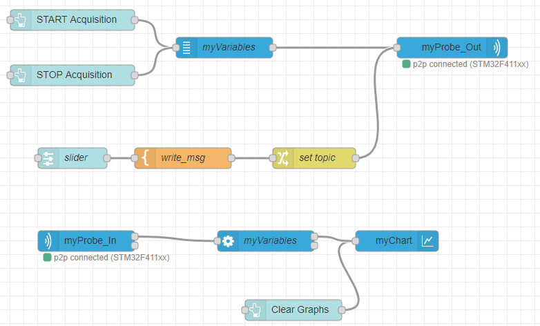

I attach the 3 nodes flow to the message.
   "variablelist": [
           "type": 4,
           "value": "xxxx"
   "accesspoint": 0
the result :
Let me know if it is ok.
