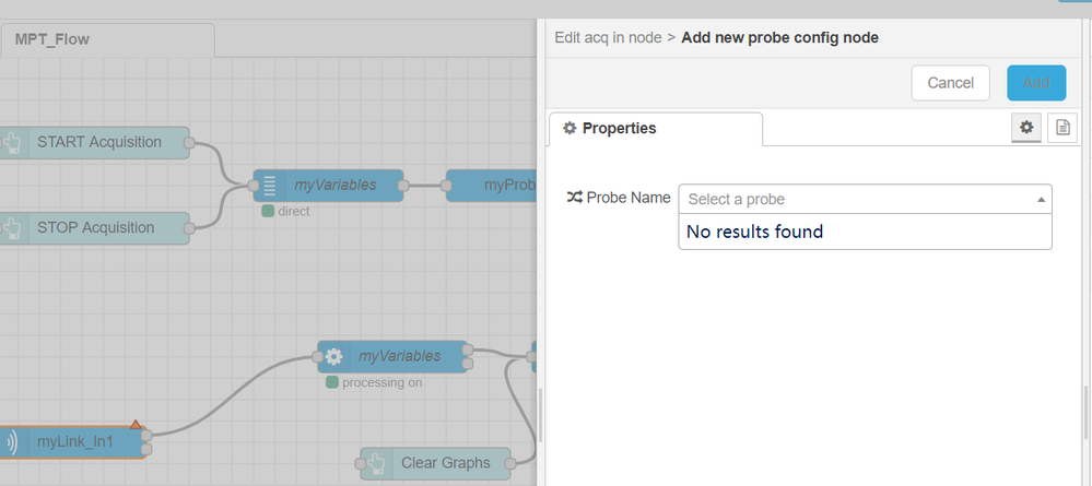

  • The cube monitor can't find my target board,but the KEIL did it.
  • what should I do? Thank you ~~

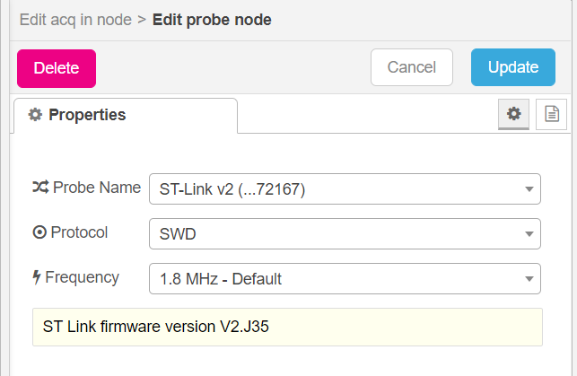

​I solved it by myself ~
update the ST-LINK firmware to the newest by STM32CubeProgrammer~

Newest is V2.J36
