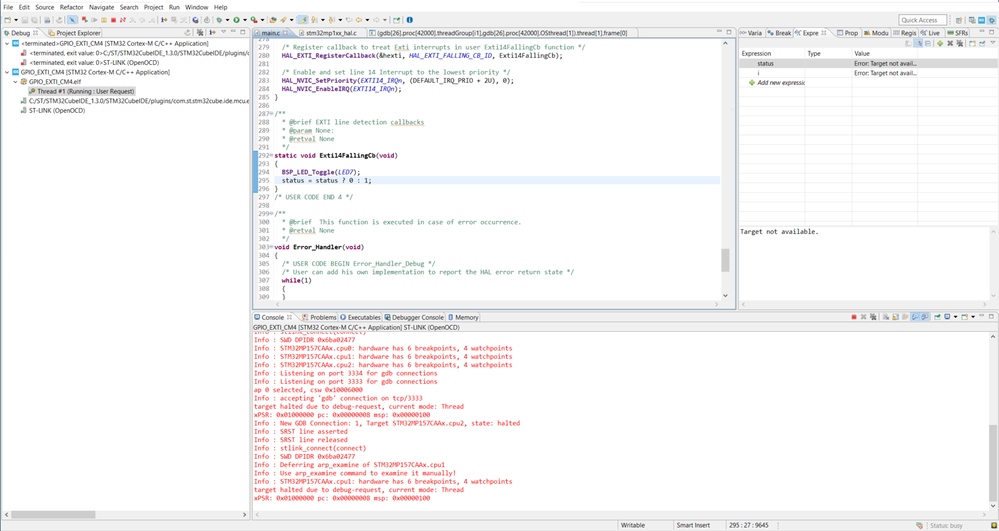

We are trying to achieve the same kind of variable watching Keil has but with the STM32CubeIDE. The variables do not appear in the Variables tab under the Debug view so we added dummy variables to the expression tab. The initial value of the variable shows fine and then when we resume the program after the HAL_Init breakpoint the 'Target not available.' error appears. Was anyone able to get the feature to work? Or are we supposed to use another program if we want this feature?

I tried that option as well, when I insert any variable inside it I'm getting "This feature is not supported" in the value column. Is there anything special I need to do to make it work?
2020-04-08 07:18 AM
It looks like you are using OpenOCD which does not support Live expressions. You need to switch the debug probe to either ST-Link GDB server or J-Link, they both support the feature.
