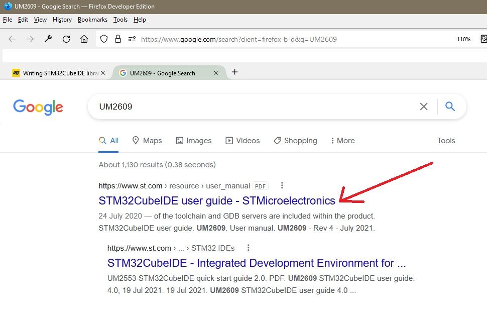

2021-11-08 9:57 AM
Where can be downloaded this user manual UM2609 rev1? I can't find it anywhere on the ST site or web.
2021-11-08 11:52 AM
2021-11-08 10:55 PM
Thanks m12lrpv, but I need rev1, here is only rev4.
2021-11-08 11:54 PM
Why do you think you need rev 1? Rev 4 is more current and won't contain as many errors as rev 1
2021-11-09 12:13 AM
Because it doesn't have this chapter "see chapter 2.5.0 - Include libraries. Assumes UM2609 rev1..."
2021-11-09 12:18 AM
Chapters in the UM2609 will have new numbers when we add new chapters preceding the one you are looking for. Have a look at chapter 2.5.8 - Include libraries in the latest manual version. Which CubeIDE version are you relying on? Probably the latest version of the UM2609 will be OK also for a number of older CubeIDE versions...
2021-11-09 12:19 AM
As per Mattias' answer... it's moved to 2.5.8
