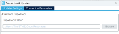

STM32CubeIDE doesn't include STM32CubeMX anymore so the option will not be in there.
The option within STM32CubeMX is located here, under Help -> Connections & Updates:
(It is editable when a project is not open.)

I'll stand corrected in that there is a way of changing it via MX. Thank you for correcting me. But can ST PLEASE update documentation for things like this? I realize that the Release Notes document says that MX was detached from the IDE integration, however it does not say anything about removing the Firmware Updater option from Preferences.
