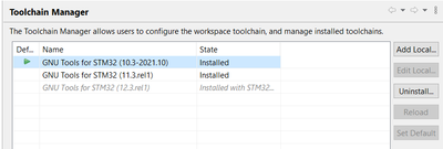

When installing and using a different toolchain (I have tried multiple and have gotten the same following issue), I get the following error:
Can anyone help, or maybe even point a poor noobie in the direction of an answer for this issue?

The default toolchain that I used that *is* capable of completing a build is GNU Tools for STM32 (12.3.rel1)
And the two that I have tried that are *not* capable of completing a build are as follows:

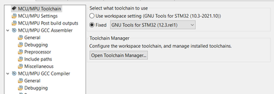

Interestingly though I have noticed one seemingly major difference when selecting different toolchains.

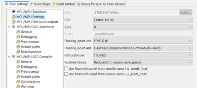

When selecting the default and functioning toolchain, 12.3.rel1, in the MCU/MPU Settings, all of the available dropdowns are filled with selections:

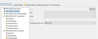

However, when selecting a different Toolchain, say 10.3-2021.10, all of those dropdowns are empty, and it also is missing dropdowns:

Okay, well, I reinstalled the program and updated, and now everything is working hunky dory. Thank you for taking the time to respond Pavel.
