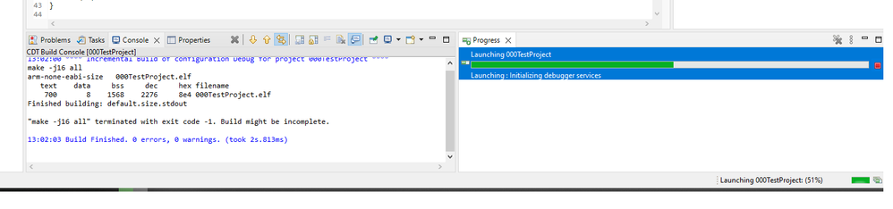

When I try to launch my debugger I see it gets stuck at "Initializing debugger services"
KVall.1
The IDE is stuck at "Initializing debugging services" during debugging

Hello there,
I would try a few things first, if nothing helps we can try to troubleshoot it further:
  • Right click the project in the project explorer and select "Index -> Rebuild"
  • Make a clean build by right clicking the project and select "Clean Project"
    • Then build the project again
  • If none of the two steps above helps, try making a new workspace and import the project to the new workspace and see if anything changes
Let me know if any of the steps above helps or not!

Hello Kvall.1,
Were you able to solve your issue?
I am having the same issue at the moment.

Hi Rim,
I posted here as well. But, I am helpless at the moment.
