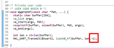

what is the purpose of -1 at HAL_UART_Transmit ?"

I copied below code from internet which works perfect while using HAL_UART_Transmit. However, I want to understand more why there is minus 1 (-1) at timeout parameter ?

AScha.3
this is what "real" C programmers like so much: writing some mystery...
-1 as INT32  is 0xFFFFFFFF  , what should give a warning here, because timeout is uint32_t ,
the nice-to-read define would be :   HAL_MAX_DELAY  . ( 0xFFFFFFFFU )

I would set a more useful/realistic timeout, say 100ms ; HAL_MAX_DELAY would wait 49 days...
