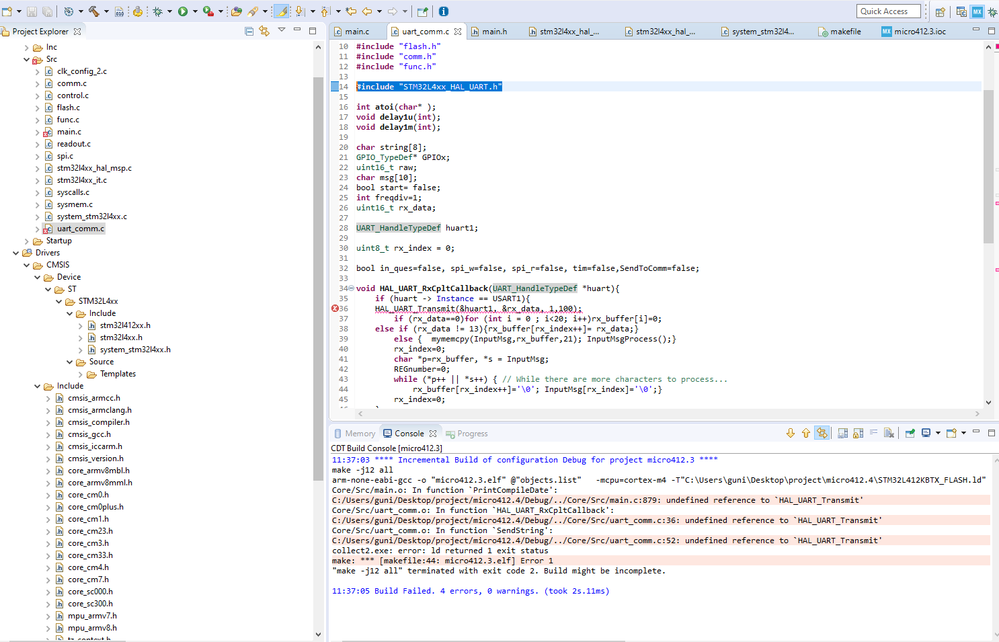

Hi guys, unfortunately, I did something that I can not spot in my project and it is not compiling anymore. cubmixIDE is saying that: "undefined reference to `HAL_UART_Transmit'" anytime I'm using `HAL_UART_Transmit'.
Gbasi.1
as people told me, i looked on "makefile" vs last version "makefile" to see any change but i couldnt spot one.
I did all necessary "#incuded" on top of the class.
I'v attached the problematic part:

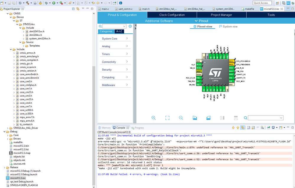

Hello @Gbasi.1​ ,
I want to ask you about the problem related to :  cubmixIDE is saying that: "undefined reference to `HAL_UART_Transmit'" anytime I'm using `HAL_UART_Transmit'.
Could you please share you ioc File where this error message appears ?
Thanks
Khouloud
Gbasi.1
problem is not in IOC file. but i will share it anyway the problem accrue in the c file as I attached above.
here i show it in picture:
Gbasi.1
0693W000005A9kIQAS.pngthat the IOC pic
