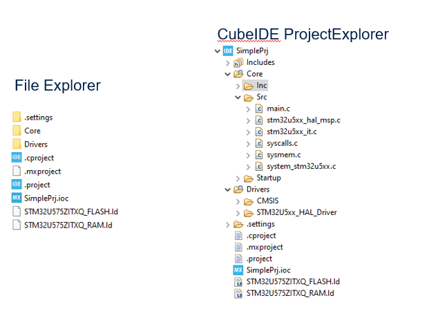

    In your case a simple solution is to put all source files inside the project folder, that is the folder containing these elements:
    • .settings folder
    • .cproject file
    • .project file
    Img 01Img 01
    The above SimplePrj example show this case. I generated it from the IDE using the [File > New > STM32 Project] menu command. Now, If I want to move that project I can copy and paste the project folder. To rename the project there are two options:
    1. Form the IDE, select the project with the cursor and right-click to open the context menu
      1. Select the command [Rename...] from the context menu
    2. manually edit the .cproject and .project file
      1. find and replace the original project name with the new one.
    Note
    Not always it is convenient to put all files inside the project folder, for example when you want to share some files between multiple projects (like the ST Middleware).

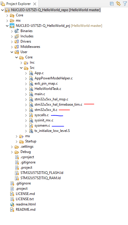

    Another thing that can create issue in your scenario is if your project is using linked resources or virtual folder.
    In the above example (available in ElooMTX-SDK in the stm32-hotspot github) the files highlighted in blue are real files inside the Src folder, but the files with a little arrow icon mark, like the red highlighted, are linked resource, that means the real file can be anywhere in the file system. This can be an issue when you copy and past the project folder.

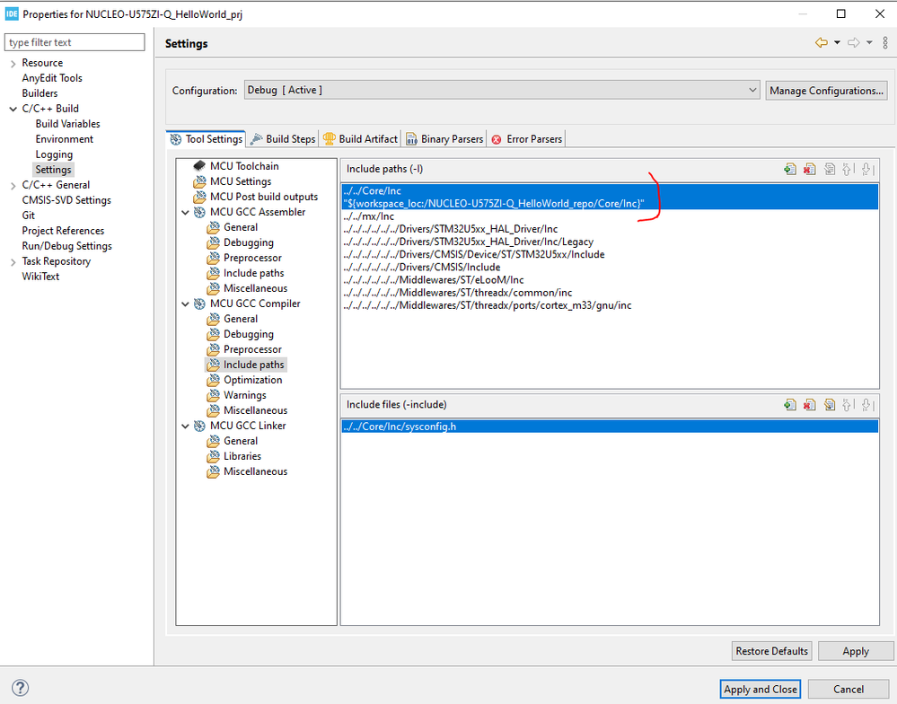

    Last thing, be careful also at the way you specify the project settings. The recommendation is to use paths relative to the project folder like in the below image.
    Have a good development time with STM32,
    Stefano
