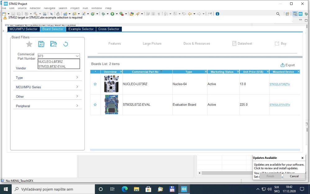

MM..1
Chief III
Or simply start new STM32 project wizard in CubeIDE and select
Thanks @MM..1​
After you do first project IDE downloads firmware and you can on my screenshot select too up Examples...
