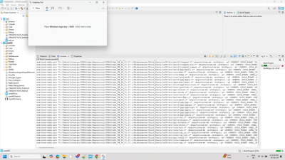

Dear All,
My STM32Cube IDE taking lost of time to compile to code previously it was taking 20sec only but now it taking 10 min and compile 20% code, please suggest what the issue,
CPU - I7
RAM - 16
CPU Utilization - <30%
RAM utilization - 10GB

How can ensure all cores are compiling the code,
I created new project by cubeMx and its working fine,
i installed latest cube ide also but also getting same thing
compiler isnot giving any error but working very slow and stuck on 23%

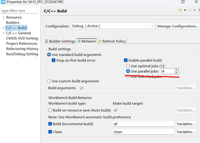

The "-j 8" on the right means use 8 cores.

I encountered this problem some days ago, the compile process would nearly stop at 19%. For my case my final solution was to adjust the parallel build jobs from 12(default) to 4, and the compilation seems back to normal. Hope this would also work for you.
