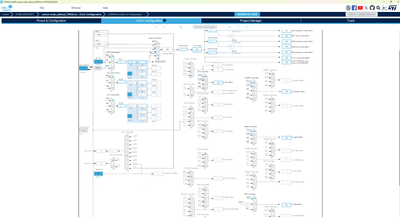

Hello @Badrinathan
I compared the two provided IOC files and identified the key differences in the clock configuration:
Without RNG:
The PLL is enabled and used as the system clock (SYSCLK).
MSI is selected as the PLL source.
SYSCLK is derived from the PLL, resulting in a higher system frequency.
Voltage scaling is set to SCALE1, providing the highest performance.
With RNG:
HSI48 (the 48 MHz internal oscillator, required for TRNG) is enabled.
The PLL is disabled (PLLState = RCC_PLL_NONE).
SYSCLK is sourced directly from MSI, not the PLL, leading to a much lower system frequency.
Voltage scaling is set to SCALE3, which is the lowest performance setting.
Recommendation:
To ensure both RNG and SPI2 function correctly, enable HSI48 for the RNG peripheral while maintaining your original PLL-based system clock and high-performance voltage scaling. This configuration will allow both peripherals to operate at their required speeds.
Please try this adjustment, and let me know the results.

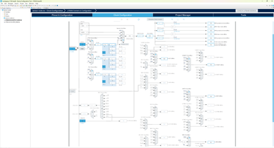

Badrinathan
Hello @Ghofrane GSOURI
Thank you for your prompt response.
I would like to clarify that I am not using CubeMX .
I am configuring everything directly in STM32CubeIDE (latest version) using the .ioc file inside the Cube IDE. I am not manually changing the voltage scaling, but as soon as I enable the RNG, CubeIDE may be automatically switches the Voltage Scaling from SCALE1 to SCALE3
Could you please explain step-by-step how to correctly keep:
  • PLL enabled
  • SYSCLK sourced from PLL
  • Voltage Scaling = SCALE1
  • HSI48 enabled only for RNG
specifically inside STM32CubeIDE?
In this Cube IDE,  I am not sure where to set the voltage scaling back to SCALE1 or how to prevent CubeIDE from changing it automatically.

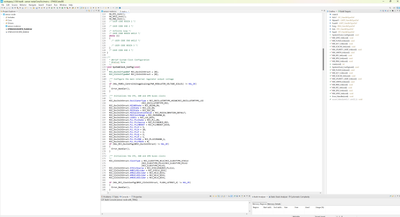

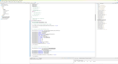

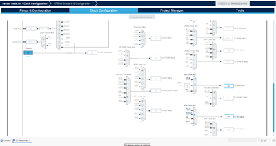

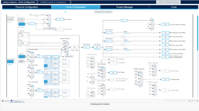

Hi @Ghofrane GSOURI
After enabling the TRNG and selecting HSI48 as its clock source, CubeIDE automatically changes the SPI2 clock source from PCLK1 to SYSCLK, which causes SPI2 to fail.
Even when I manually switch the SPI2 clock source back to PCLK1, the issue persists and SPI2 still does not work.
parameters' also changing automatically.
Please find attached the clock configuration on snippet and the IOC file with the TRNG enabled.
